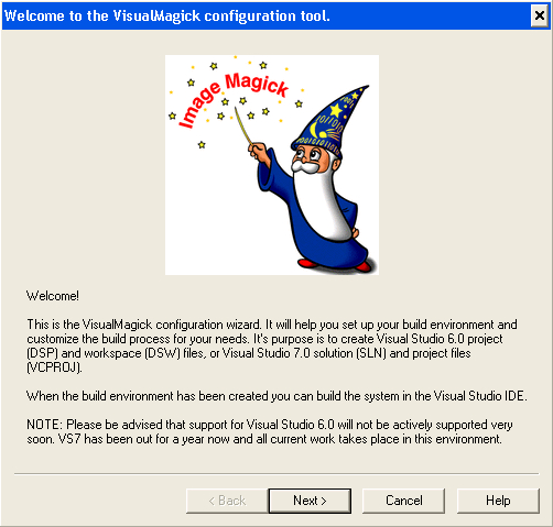

Next, launch your Visual Studio IDE and choose Open->Project. Select the configure workspace from the ImageMagick-7.1.2-25/VisualMagick/configure folder and open configure.sln. Choose Build->Build Solution to compile the program and on completion run the program.
    [configure]
Press Next and click on the multi-threaded static build. Now press, on Next twice and finally Finish. The configuration utility just created a workspace required to build ImageMagick from source. Choose Open->Project and select the VisualStaticMT workspace from the ImageMagick-7.1.2-25/VisualMagick/ folder. Finally, choose Build->Build Solution to compile and build the ImageMagick distribution.
The configure.exe utility can also be run on the command line instead of through the GUI wizard. You can see an example in our GitHub actions build.
