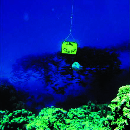

So, I hurried up a little bit. Here are some images for demonstration:
first, the CMYK source image:

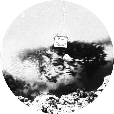

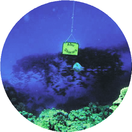

convert mask.jpg source.jpg -compose Screen -colorspace cmyk -composite result_2.jpg
convert mask.jpg source.jpg -compose Screen -colorspace cmyk -profile ISOcoated_v2_300_eci.icc -composite result_3.jpg
convert mask.jpg source.jpg -compose Screen -profile ISOcoated_v2_300_eci.icc -composite result_4.jpg
Interesting that this source.jpg shows a slightly different color "behaviour" than the one I described above in the first post.
But it is also clear that the colors are not in any way similar to the ones of the original image.
