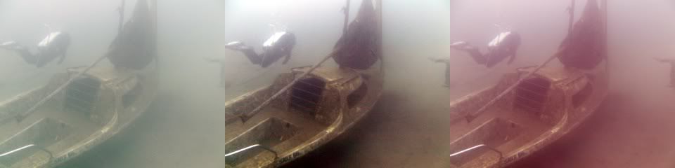

I´m really absolutely confused. Using mogrify or a single convert produces different results all the time, i know. But even if i run a script (bat or cmd, Windows 7), that´s opening a new cmd for each convert-process, the result is not nearly as good as a convert command manually invoked in cmd.exe.
The command I´m using is "convert <source> -channel RGBA -contrast-stretch 1% -quality 100 <destination>" which delivers amazing results used with underwater-pictures. But, as I already mentioned, only if it´s invoked manually.
I already thought about differences using ' or " (I´m running a german version of windows) etc. But I don´t get it.
To show what it´s about (original, manually invoked, invoked via batch):
Any idea/suggestion/explanation would absolutely be appreciated, thanks.

OMG...Many, many thanks pal. I was just 2 blind 2 see, using -contrast-stretch 1%% is the clue.

As you have included -channel RGBA (or even -channel RGB), then -contrast stretch will stretch each channel separately. It appears you need to stretch all the channels in concert. To do that leave off the -channel RGBA. Try that.convert <filename> -channel RGBA -contrast-stretch 1% -quality 100 <targetFilename>
This seems to give me something close to what you want, you may want a higher percent on the -contrast-stretch
You can use -level or -brightness-contrast to get similar results to what you want.
