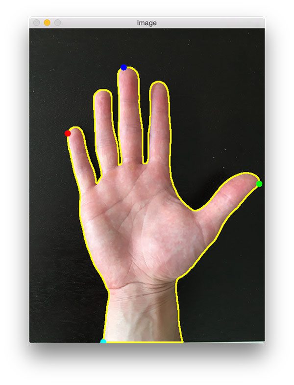

I think diegomage wants the top-most point of the hand, and the left-most and right-most and bottom-most points.
If so, then make a white hand on a black background. "-trim" finds the bounding rectangle. The first white pixel in that image is the top-most point of the hand. Crop to the first column, and any white pixel in that crop if the left-most point of the hand.

But that does not find the cyan dot in at the lower left of the hand. I think he would need the convex hull corner points. So perhaps see http://www.imagemagick.org/Usage/morpho ... convexhull

I don't know exactly what is wanted. Perhaps the cyan dot is (one of) the bottom-most pixels in the hand.
True, it could be the most south-west point. But the most south-east point isn't wanted?

Re: exist an method for find extreme points in imagemagick?
the instersection points between the convex hull and the countour of this hand
the red points of this image for example

These are two different problems.
This would be about 20 pixels. Okay, then get the convex hull (see http://www.imagemagick.org/Usage/morphology/ ) and the edge, and find the intersection.diegomage wrote:the instersection points between the convex hull and the countour of this hand
This would be seven pixels. Perhaps these are the vertices of the convex hull.diegomage wrote:the red points of this image for example
