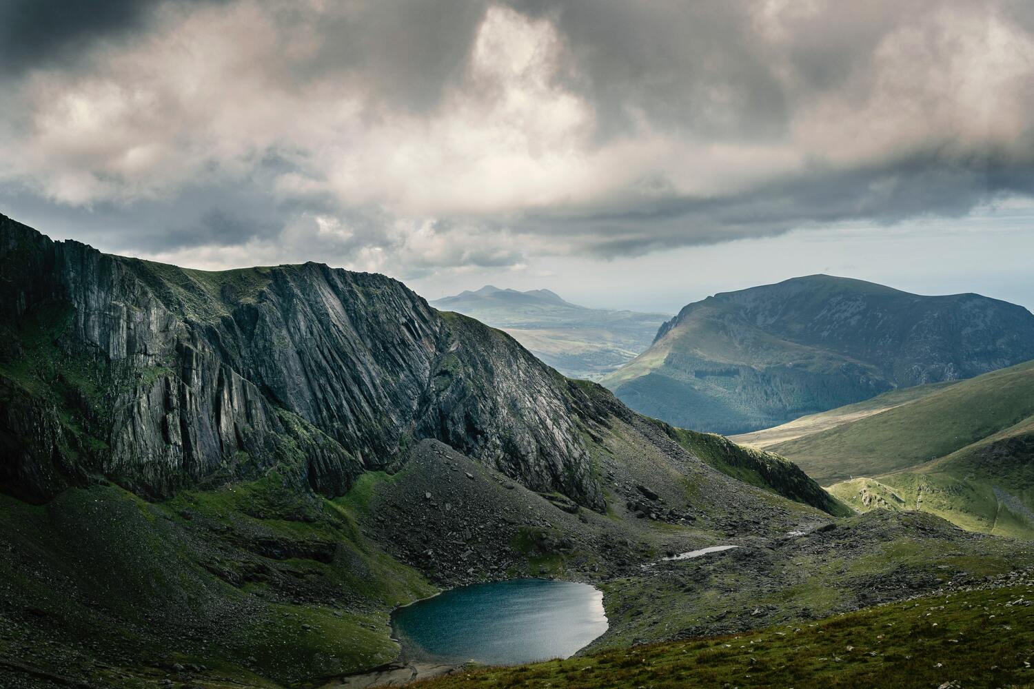

To visualize the benefits of CLAHE, we have a low contrast image of mountains:
    label

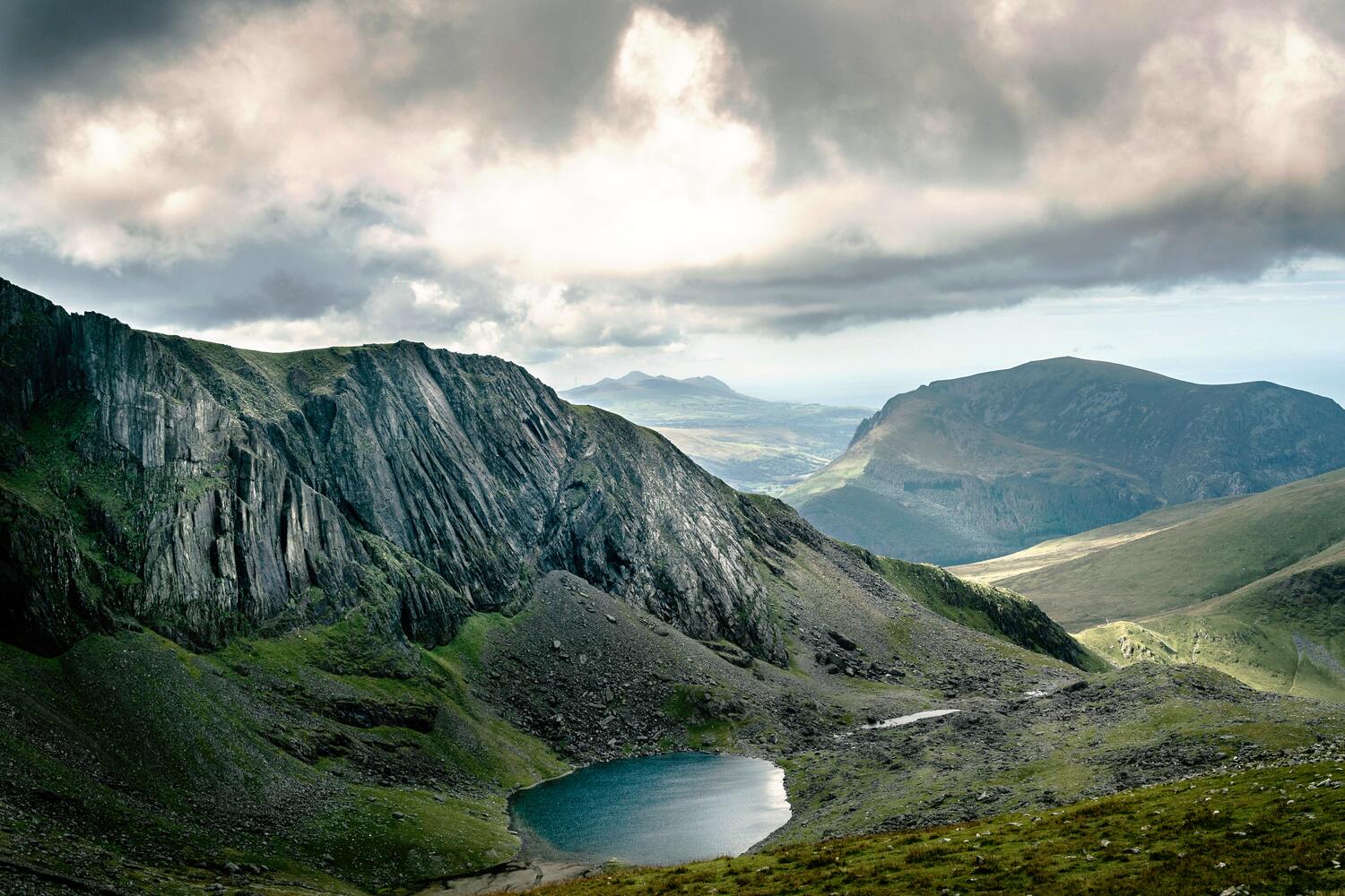

We can improve the image with global histogram equalization:
    label

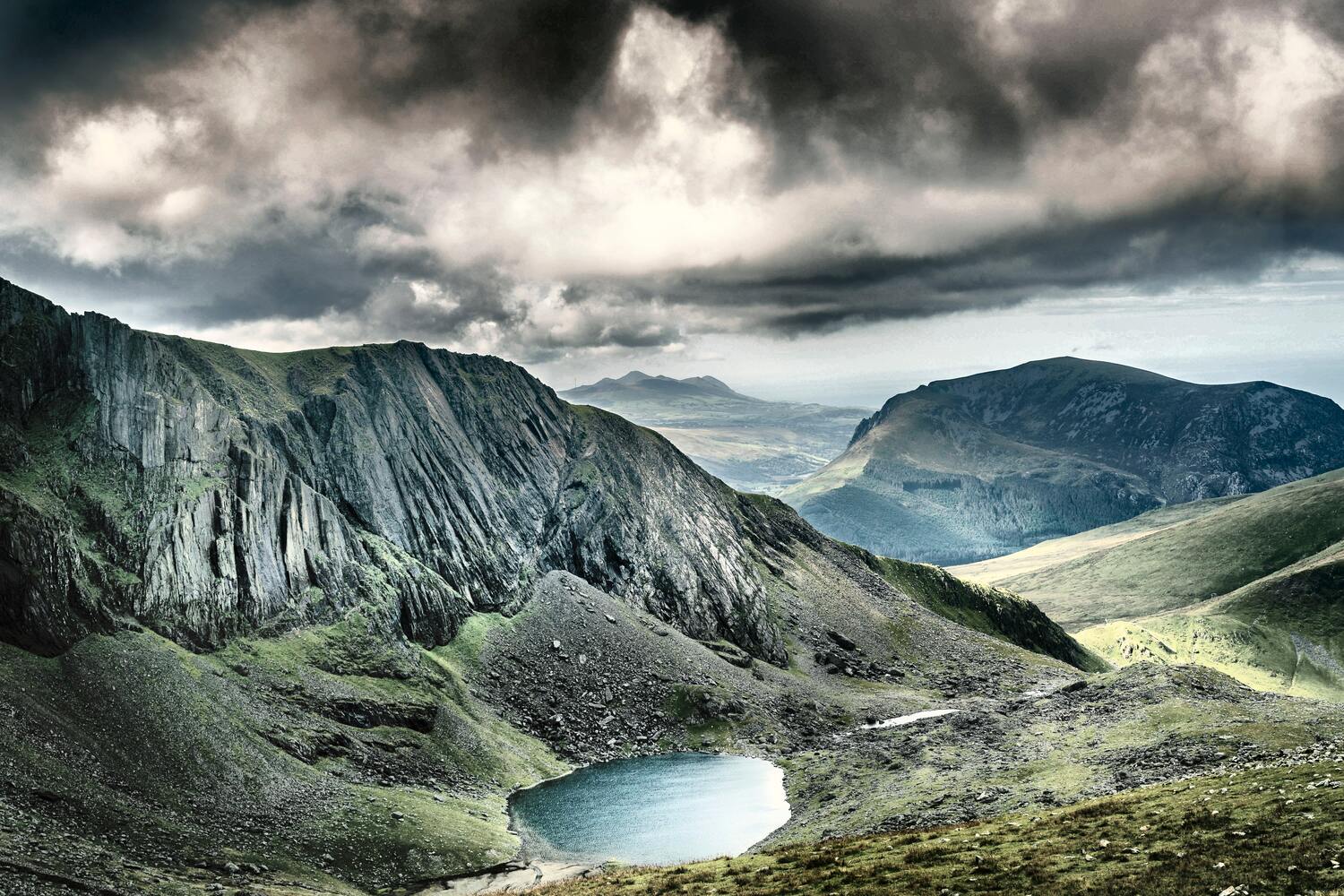

We can further improve the image with the contrast limited adaptive histogram equalization image processing technique:
    label
The latter image was produced with this command:
The 25x25% argument divides the image into 16 tiles to perform local contrast enhancement. The image dimensions are 1500x1000 so the tiles are exactly 375x250 pixels each. Rather than a percentage, you can specify the tile dimensions directly with 375x250.
