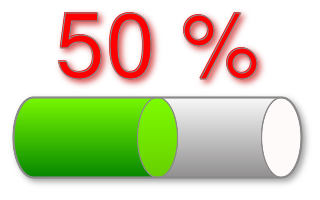

Here we show percent completion of a task as a shaded cylinder:
Given the complexity of the rendering, you might be surprised it is accomplished by a single command-line:
magick -size 320x90 canvas:none -stroke snow4 -size 1x90 -tile gradient:white-snow4 \ -draw 'roundrectangle 16, 5, 304, 85 20,40' +tile -fill snow \ -draw 'roundrectangle 264, 5, 304, 85 20,40' -tile gradient:chartreuse-green \ -draw 'roundrectangle 16, 5, 180, 85 20,40' -tile gradient:chartreuse1-chartreuse3 \ -draw 'roundrectangle 140, 5, 180, 85 20,40' +tile -fill none \ -draw 'roundrectangle 264, 5, 304, 85 20,40' -strokewidth 2 \ -draw 'roundrectangle 16, 5, 304, 85 20,40' \( +clone -background snow4 \ -shadow 80x3+3+3 \) +swap -background none -layers merge \( +size -pointsize 90 \ -strokewidth 1 -fill red label:'50 %' -trim +repage \( +clone -background firebrick3 \ -shadow 80x3+3+3 \) +swap -background none -layers merge \) -insert 0 -gravity center \ -append -background white -gravity center -extent 320x200 cylinder_shaded.png
Run this script contributed by Geemack. You'll get a glimpse of the power and versatility of the ImageMagick command-line:
