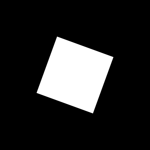

For example, consider the following white rectangle on a black background:
    [Convex Hull]
The convex hull set of points may be computed as:
magick rect.png -format "%[convex-hull]" info:
190,121 193,122 281,154 377,189 378,190 377,193 345,281 310,377 309,378 306,377 218,345 122,310 121,309 122,306 154,218 189,122 190,121
The convex hull may also be drawn as a polygon (filled or unfilled) using -draw as follows:
magick rect.png -set option:hull "%[convex-hull]" -fill none -stroke red -strokewidth 1 -draw "polygon %[hull]" blocks_hull.png

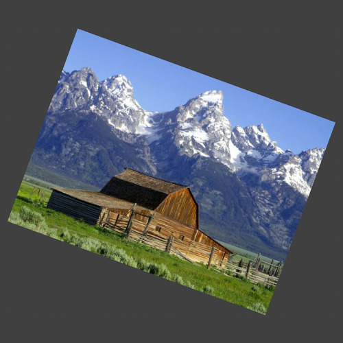

Finally, here is an example with a non-constant, non-black background using -fuzz to determine the background color:
    [Convex Hull Barn]
Now let's highlight the convex hull of the image foreground object:
magick barn_rot20.png -fuzz 10% -set hull "%[convex-hull]" -fill none -stroke red -strokewidth 1 -draw "polygon %[hull]" barn_rot20_hull.png
    [Convex Hull Barn Closure]
Minimum Bounding Box
Similar to the convex hull of the image foreground object(s), is the minimum bounding box. Use %[minimum-bounding-box] to return the points that make up the bounding box. In addition, these properties are set: minimum-bounding-box:area, minimum-bounding-box:width, minimum-bounding-box:height, and minimum-bounding-box:angle.
magick barn_rot20.png -fuzz 10% -background gray25 -set MBR "%[minimum-bounding-box]" -fill none -stroke red -strokewidth 1 -draw "polygon %[MBR]" barn-mbr.png
Unrotate an Image
Use %[minimum-bounding-box:unrotate] to correct for any rotation the image may exhibit. Unless you specify the image orientation, the unrotate angle should properly align the image to the correct coordinate axis for angles <= 45. For angles > 45, the image will align with the wrong coordinate axis. Set the correct image orientation to ensure the proper unrotate angle is returned. Use -define minimum-bounding-box:orientation={landscape,portrait} to set the image orientation. Note, that like convex-hull, the string format is sensitive to an optional -fuzz value and an optional -background color.
The barn image above is rotated by 20 degrees. Here is how we can automatically correct for the rotation and return it to its original landscape orientation:
magick barn_rotate20.jpg -fuzz 15% -set option:angle "%[minimum-bounding-box:unrotate]" -background gray -rotate "%[angle]" -trim barn_unrotate.jpg
